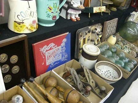

Anyone out there know their Stanley’s well enough to narrow down what these two are…they’re from an estate coming up this week in Seattle:

Tough to say from this small pic and at a distance. Are you even sure they are Stanley's and not Sargent or other bailey clones? Nayway, if I had to guess, I'd say the larged one is a 5 (jack plane) and the shorter (wider?) one is a 4 1/2 smoother. Here's a pic with my 5 (refurbished in green) and 4 1/2 next to each other in a drawer FWIW:

The auctioneer identifies them as Stanelys, and he's usually accurate at least on the maker. Thanks for the pic of your plane drawer. I have a box-o-planes that TMS helped me identify awhile back, I've got to refurb them and get 'em in a nice drawer like that.

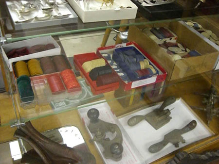

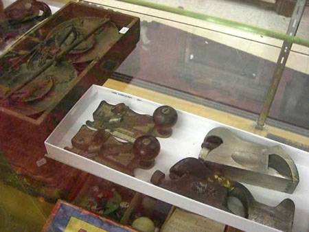

Ah! I took a more complete trip through the photos. Check these out, looks like I have some research to do:
And a spokeshave, scraper plane and a router plane. Did I get those right?:

Hi FG.... Happy & Healthy New Year In the upper photo....
two planes on left are Stanley #99 (Left hand Rabbet Planes) Yes there is a #98 which is the Right Hand rabbet) Made from 1897-1973
The upper right is a #90 Stanley Bull Nose Rabbet plane (1898 - 1973 and the lower right looks like a Stanley #90 Cabinet makers Rabbet Plane (1902 - 1973)

The Router plane is a Stanley #71 (1885 - 1973) or #71 1/2 (1896 - 1949. I can't tell too well from the photo. The #71 has an open or arched front while the #71 1/2 is 'flat' in front. The upper right again is a Stanley #80 (1896 - 1958) or #81 (1909 - 1941) Cabinet Scraper. There are just too mant spoke shaves so I won't even try to ID it. SawdustSteve

The small funny looking planes in the top photo are side rebate planes probably Stanley the Record version is slightly different I am not sure wether they were made in right and left hand versions .

J. the first pic does look like my #4 1/2 and a #5 or #6 hard to tell. Will they let you pick them up and inspect them? Most Stanley's have their # either on the upper surface on the toe or the heel of the plane behind the tote. The logo name on the cap changed over the years and can get you closer to the age if you can id it.
More important is your eye ball of the blade mouth on the bottom( it must be a crisp rectangle not rounded on the front edge or sides) and a look to see that the casting has not been brazed or repaired (usualy creeping up the sides from the corners of the mouth).
The # posted by others are good , you should look at them in Leache's listing to get a feel for them. A #80 sells for $25, a #98-99 for up to $95 each if clean/with the depth stop and enough iron left . Good luck, Paddy
Hil, Paddy. Yep, we can look all we want. This auctioneer is my favorite. Thanks for the info.forestgirl -- you can take the girl out of the forest, but you can't take the forest out of the girl ;-)
