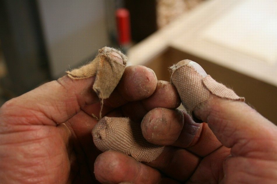

… on the side of all rebate planes, especially skew rebate planes. I cannot recall a time that I have finished a planing session without cutting all my fingers. This is near the end of today … View Image The problem is that I prefer to push the fence against the edge of the board rather than hold the knob (which is safely out of harm’s way). My fingers are close to the blade. When it comes to skew blades, I forget that they extend further back (than in line with where I think they end), and so I inevitably slice a finger tip! This is not confined to skew rebates, however. I do it on all rebate planes! Here are a few illustrations. I was making rebates and raised panels. No, I am not left handed – the grain just went that way … View Image See here .. View Image So how do you hold a rebate plane? Here is an update of the wardrobe I am building. The doors are a dry fit. Tomorrow I will drawbore the mortice and tenons, fit the hinges, set the inlay, and fix the face frame. Then it’s the drawer, top and base. It’s good to have a week’s grace before my wife’s family descend on us. This piece is needed for a guest room. View Image Regards from Perth Derek

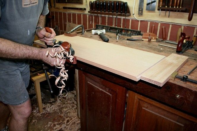

Blimey Derek, looks like youll need help fastening your trousers, speaking of which thats a bit much showing pictures of you working away in shorts while its freezing here in England.

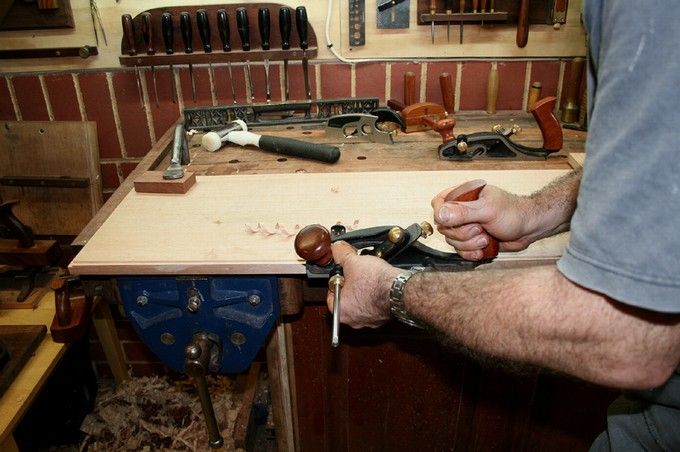

I have the right-hand Veritas Skew Rabbet plane and have yet to cut myself with it. I put my thumb around the base of the knob and apply pressure on the fence with my fingers. I guess that puts my left hand forward of the blade. If you hold the plane this way, you do need to be a little more careful at the end of the cut.
Have you got the extra-long fence rods on your plane? I wonder if that has any bearing on how you hold the plane...
Hi Chris
I have a couple of methods of holding this plane ... but I end up cutting myself anyway!
Yes, I have the long rods. I will be putting together an article on how to use this plane - tips and mods.... minus the blood!

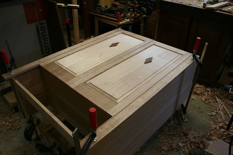

Nice wardrobe !
( is this the same as what we in USA (or France ?) call an armoire? This looks a bit smaller but not sure.
Hi Roc
This is to be an armoire. It is smaller looking, but that is the design as it is intended for a small guest bedroom. The focus wasto reduce depth, and to do this I have arranged that the hanging space is facing you, rather than side-on (you sight down the rail when you open the doors).
I too suffer terrible cracking in my fingers (how we suffer for our art!). The best moisteriser that I have found is made in the USA, called "Renew". Fantastic stuff!

Derek, You have defined truly hand made, just add blood. Your blades might be to sharp :) Nice work.

That is a nice cupboard and looks like it will safely hold at least two naughty children, even should they kick and scream. Alternatively, you could buy and try some trouser, as there is enough depth for full-length strides in there.

Anthony Giudice describes how to hold planes in "Four Squaring with Hand Tools" which you can find on the FWW website. He says:
"And don't hold the plane so that you can guide it with your fingers underneath. Hold the plane by the handles. Your eyehand coordination is better than any gimmick or
trick grip."
That answers your question. Glad to help.
Now I have a question for you. In Four Squaring with hand tools, some recommend starting with a scrub plane, while others recommend starting with a Jack Plane with a highly cambered Iron. Is each better under some circumstances, or do you recommend one approach over the other? Why?
This is not a trick question. I really would like your ideas on this. I don't have a scrub plane yet and so I have not been able to compare it to using the Jack. My guess is that you have tried both approaches.
Looking forward to your response. THank you.
Happy New Year.
Hi Mel
Scrub or jack? It depends on the wood.
If there is a lot of waste to remove, I grab the scrub (there is a comparison of different scrub planes on my website). For example, I have a 10" x 4" roofing beam that will make a great bench. It requires serious dressing. The Veritas scrub is the go-to plane here. I prefer a longer, heavier plane as a scrub.
Otherwise I go for my jack. Actually I have two jacks set up - one with a camber that is just short of the scrub (Stanley #5 1/2), and another that is more moderate (that is a 15 1/2" long woodie I built). I tend to use the latter the most since this is enough to remove moderate warps, etc.

I am knee deep in some bedside tables, and I have sanded the ends of my finger tips off on my thumb and forefinger. I see you prefer the flexible fabric strips as well. Nice to have a box around the shop, as trying to stain the entire project a blood red color could be a bit more than I can spare.

How about Kevlar gloves?
http://www.vestguard.co.uk/gloves/sand-kevlar-defender-gloves.htm
And I wonder. Is it the edge of the wood and not the plane blade. The edge of Panga-panga and Jatoba can be like a razor! AND Lacewood!
Lee Valley's High Friction
Lee Valley's High Friction Guard Tape. $4.95 for 90 feet.
http://www.leevalley.com/wood/page.aspx?c=1&p=31213&cat=1,42207

When I was into pottery, the best skin moisturizer we could find was udder balm. From wedging clay and washing up potters end up with rashes all the way up their arms, not just the finger tips. It smells,used on cows but it worked better than anything.
