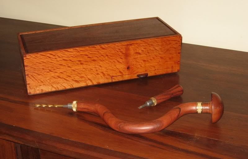

I am current making a new brace to replace the one I built for the WC competition last year.
I gave that one away as a gift. The new one will be for myself.
The materials are a Tasmanian Blackwood head with a She-oak body. Man, the She-oak is Hard. I roughly cut out the shape on my bandsaw, then tried to spokeshave it - all I tried just bounced off. So I have rasped it all.

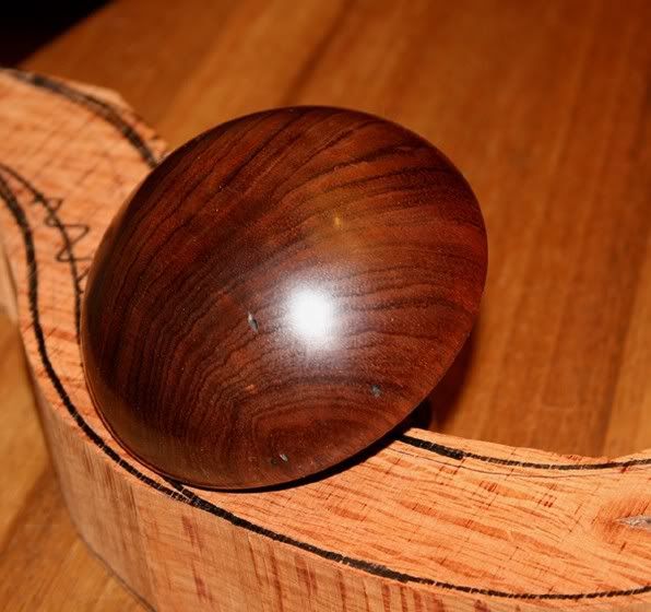

Here is the head ..
Derek,I have been wanting to make myself a brace for years (inspired by this catalog cover) but haven't figured out how to make the hardware. Where did you get your nice fittings from?

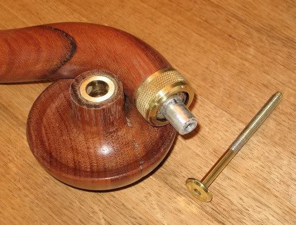

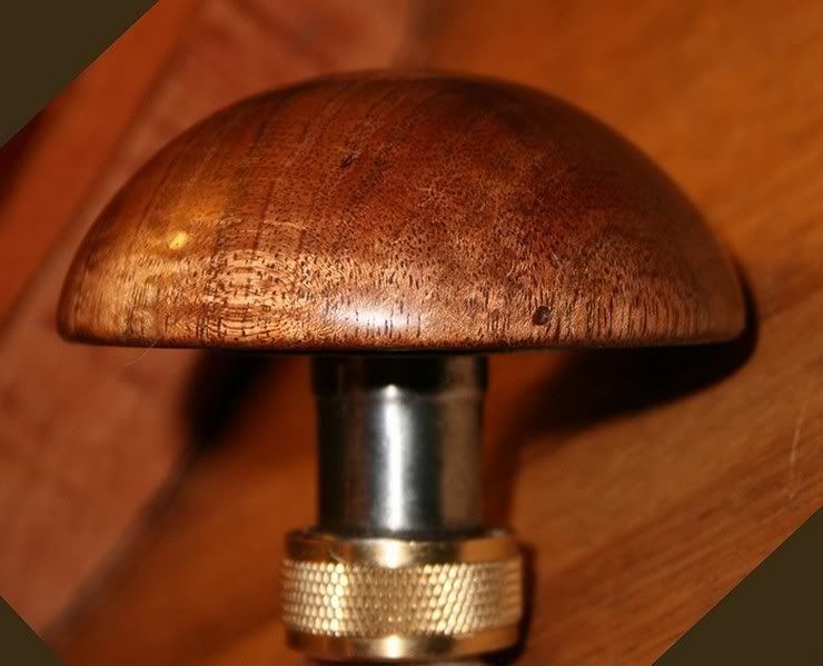

Hi Chris
In the first brace I made a fitting for the head out of steel rod into piping. Then epoxied the ends in and connected with an allen head bolt ...
It was not quite flush when it turned and so, with a rush of blood to me head (feeling white obsessional at the time), I epoxied the contact so it would not move. I immediately regretted this - there was a charm to the imperfections. I should have just accepted it. Anyway I gave it away as a gift later, telling the new owner that he could free it up with a little heat. Later, when the competition was judged, Christopher Schwarz marked me down as a result of the fixed head. Who knows what would have resulted if I had been more tolerant.
In this current I was determined to get it right. So far so good. The mechanism comes from an old, decrepid Stanley brace. I cut off the important bit, removed the rust with a deburring wheel, and have fitted it. It moves as smooth as Philip around the ladies.

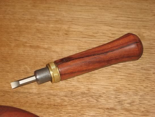

The other end, the bit holder, is (in another life) a clip-on holder for drivers. The brace is small and is designed for holes for screws. In other words, an alternative to a eggbeater. And may alsoi be used as a screw driver. Here is a close up of the driver I made as part of the original set. I deburred off the anodising and back to steel...
Hope that helps.
Some features ..
