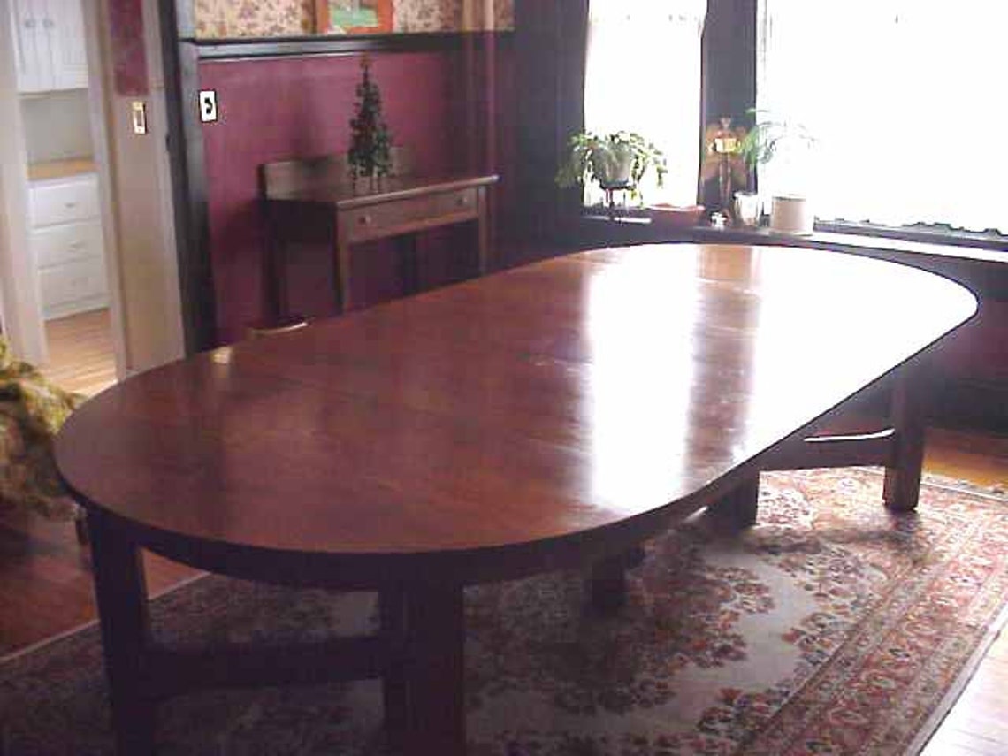

https://i.etsystatic.com/5556887/r/il/c11ae2/385815167/il_1140xN.385815167_3v91.jpg
https://daltons.com/wp-content/uploads/2020/02/634-3.jpg
Thanks MJ. I'm definitely planning on including expansion leaves. I've seen the pics you attached. The pedestal will split diagonally to allow the table to open. Since this will be hollow inside (to allow for QSWO on all four faces), I'll add reinforcing blocks inside. I'm thinking I can use a screw or dowel through the top block into the table top.
