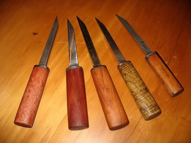

Look for long bladed, tanged, mortise chisels, with or without handles in sizes 1/4" and 5/32". Look to pay about $10 each or less.
Forget the brand names. Look for tanged firmers with long (3-5") thin blades. Buy as many as you can bottom feed around 1/2" wide. You want as many chisels as possible- preferably every 1/16" from 3/16- 5/8". Pick up 2 larger firmers with similarly thin blades in the 1" width range. When I say thin look for a tool that is less than 1/8" thick at the top of the cannel.

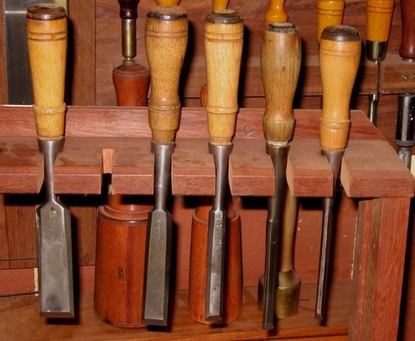

My preference is for shorter paring-type chisels, especially tanged types as these are lighter and have a more delicate feel than most socketed chisels. Bergs would top my list. I prefer pushing a chisel to the use of a mallet, so light is my priority. I also do not like very wide chisels. 1 1/4" is wide enough for me.
Of the socketed type, the Witherbys I have would really satisfy most demanding users for balance and edge holding whether pushed or hit. I also like the balance of Stanley #750s.

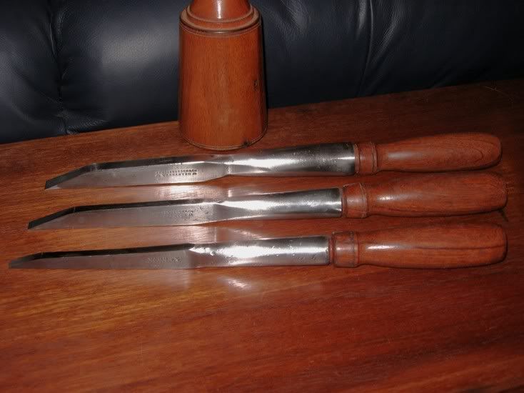

Mortice chisels? I can only recommend one type, oval bolstered types (aka "pigstickers"). The combination of depth of blade and a directional handle make these the easiest to use.
I did restore and re-handle some Ibbottsons. These were terrific chisels but the round handles were not as controllable as those of the OBMC:
