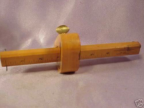

The "wheel" gauges ala Titemark have round blades, but calling them wheels makes it sound like the blade spins freely in use, when in fact they are fixed with a tightened screw.
The main difference is that the wheel gauges cut/slice whereas the pin gauges tear, unless you grind the pin to have a flat side.
There are really more than two types of gauges --- there are also gauges with two pins or cutters for marking tenons. Also, when it comes to cutting gauges, the bevel becomes a factor -- facing out for some purposes, facing in for other purposes. Once you start using gauges, the importance of this will become more apparent to you.
I have several gauges of various types and find that it is often useful to have several so that one can keep them set during a larger project. Gauges are not expensive so my recommendation is to try out several kinds and see which you like to use. A lot of this comes down to personal preference, so you will probably hear many recommendations of what people like the best. Even cheap wooden gauges can work effectively if you put in some time to modifying them. Among the wheel gauges, ones with micro-adjust (like Tite-Mark) are a bit easier to set one-handed (in my experience), but even the ones with single adjusters can be used effectively. That's what 15-year-olds use in our school's workshop, and they seem to work fine for them. (the basic ones from Lee Valley).
I'll share one tip about marking that I have found to be effective. Even though marking gauges with double cutters/pins are called "mortise gauges," I actually use a single cutting gauge to mark a mortise. I mark one side of the mortise, then use a pencil and square to mark lines perpendicular to it -- chiseling on each line with a mortise chisel. Then I use the "mortise gauge," set to the width of the chisel, to mark the tenon. I have found this to be effective. This way, I can keep the two gauges set for the entire project. After all, the distance from the face edge of the mortise might not be the same distance set for the tenon from the face edge --- I'm not sure if I'm expressing that clearly, but it works for me. Perhaps I need to learn to post pictures.

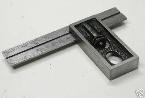

My most commonly used layout and measuring tools are a Starrett 4" double square and a Starrett 6" rule. My marking gauge is an old Stanley 65 with a piece of drill rod ground to a knife edge and honed very sharp. It slices through the wood without tearing it, and won't follow the grain. When I need a fine line, I use an exacto knife. I don't need a mortise marking gauge since I now own a mortising machine. I am partial to Starrett tools for measuring and marking. eBay is a good source for Starrett tools. Tom

I tried the older style wooden and brass marking gauges of both the single and double pin type. These tend to dance about a bit if the grain grabs the point(s). Rather than sharpen the points into mini-knives (as some folk do quite successfully, I hear) I tried the wheel-based markers.
I now use a basic veritas for single line-marking and one of those Titemark gauges for mortise-marking, using one of the several fixed-width twin-edge wheels they can be mounted with. This approach seems to allow accurate, straight and (when necessary) deep incisions to be made quickly and easily. Two gauges does help as there is much less resetting required.

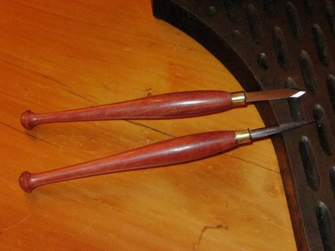

I also use a Blue Spruce marking knife for lighter work like marking out DTs and finger joints. They are slim with a diamond point and easily got into the recesses.

Square: Starrett 6" double square on eBay or the LV version.
Marking gauge: Here are two, a wheel and pin. I have both the Veritas wheel guage and the Tite-Mark version. Best value is the Veritas with the TM cutter. I found it difficult to get a sharp edge on the Veritas wheel. The TM fits and it a great replacement.
The other marking gauge I like is a vintage Stanley #65. This automatically lays the pin at the ideal cutting angle. Mine is sharpened like a knife.

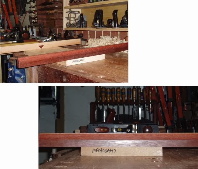

Winding Sticks: An essential tool. Make your own (and if not, Lee Valley sell an aluminium set)
Marking knife: Another one to make for yourself. I recommend a pencil type, made by Blue Spruce and Chester Tool Works. Or make your own - here is my tutorial: http://www.wkfinetools.com/tMaking/art/markingKnife/markingKnife.asp
One of mine, knife and awl...
I really like the marking knifes and I have a nice piece or rose wood that would be great. I willlet you know the progress. Dan Carroll
