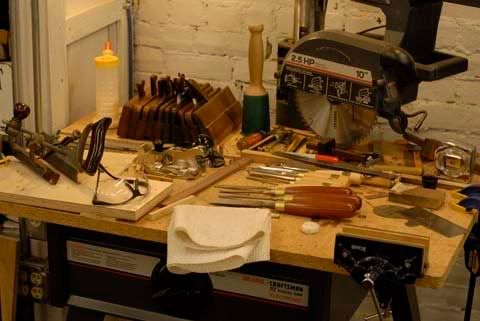

I just needed to get a few more planes goin’ so I can make some keystones… I’d never used some of H&Rs and snipes bills in the collection, so they needed a little work. Also sharpened up a few gouges and straight cutter for the Craftsman combo plane (Sargent 1080, I think). Here’s the arsenal, except for the RAS:
The RAS is just holding the work surface down. 😉 Man, I need to sell that thing and make a real bench, no?

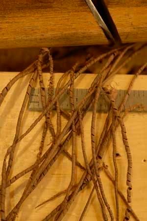

Then I switched to H&Rs, a shoulder plane and, lastly, carving chisels and scrapers. The Rounds make the funniest little shaving:
