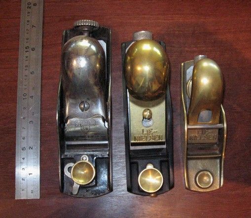

My go-to block plane is the bronze LN #103 (standard angle). It is small and extremely comfortable in the hand - but with authority! - and is just the sweetest performer on both face- and end grain.
I also have the LN LA #60 1/2, with adjustable mouth. This is a nice size for an traditional small block plane.
Another is the Stanley #65 (with Hock blade). This is probably my best performer in terms of being able to take the most delicate, fine shaving. However it is less robust as it is constructed of grey cast iron, so it lives on the shelf alongside the bench.

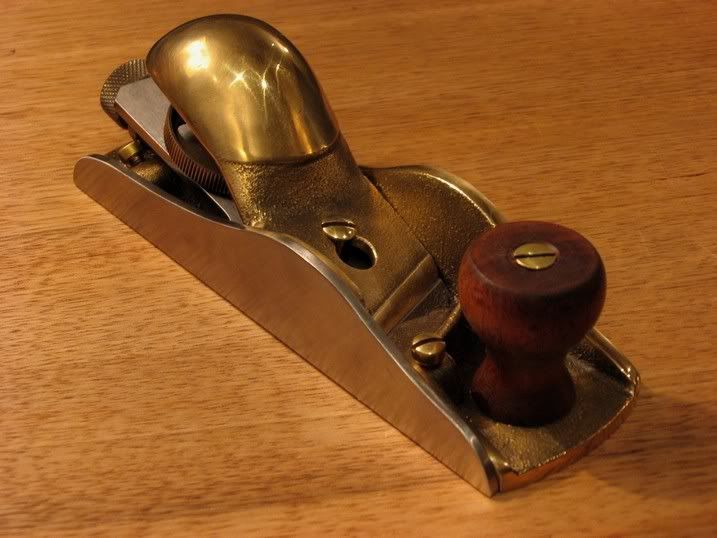

A recent addition has been the bronze LN #140R (skew block plane), which was the subject of a total restoration (I posted this here some while back). For cross grain work (such as tenons). It is now a superb performer.

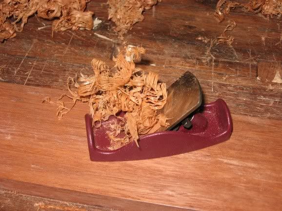

In fact, I am so underwhelmed by BLOCKPLANES that I even made a small plane that performs far better than any blockplane.

..... and then I love using block planes. Next to paring chisels and spokeshaves they are amongst my favourite hand tools.
Stanley #65, LN LA #60 1/2, LN #103
They are light and have "feel" when something small requires a little finesse. I like using them on the shooting board where a large plane dwarfs the edge. They make terrific small smoothers when the cutting angle is high. Or even small scraper planes, such as in the case of the Veritas "Little Victor" with a reversed blade.
I spent some time, with the help of Thomas Lie-Nielsen, restoring this #140R to usable condition. It is special, not only because it is great on tenon faces and other cross grain work, but because it was one of the first planes they made.

Chris , you and Hammer are taking me far too seriously, but there were one or two serious points...
Admittedly there were some ulterior motives to the post as well-such as finding out exactly what folks are using these planes for. Also interesting to observe what assumptions we make about each other.
Actually, I have never made a wooden plane, much less a wooden block a la Krenov- perhaps I could fit one in before it is too late. But I have made several small metal planes with knob and tote which I would far rather use for any tasks so far listed for block planes.
I don't agree with the view that one cannot use a small knobandtote one handed: even one as big as a number 4 is easily used one handed. I think just the opposite in fact, especially if there is some weight to the plane and the tote is suitably shaped.Philip Marcou

I have a Veritas standard angle block plane, the first plane I bought. It used to do all my planing (there was no other). Since acquiring other planes with totes and knobs (large and small, from one P. Marcou and also Mr Lee) I do find the Veritas block plane now hardly used.
Some typical block plane jobs are said to be: end grain planing; chamfering/rounding edges; final fitting of joints like M&T; paring off DT or finger joint protruding ends; fitting small parts like doors in a frame or lids in a box. I find that I now use either a small plane of the tote/knob kind,a shoulder plane or a spokeshave for these tasks - with one exception.
I also have a Lie Nielsen 140 skew block plane, which is low angle, has a removable side, a fence and a knicker. These features make the 140 useful for all kinds of small jobs including the clean reduction of endgrain protruberances (those DT and finger joints); but also (amongst other tasks): cleaning out TS-cut rabbets, fielding small panels and cutting a rabbet across the grain in smaller parts (eg a la Cosman prior to making DTs in drawer parts).
None of the tote/knob planes do these things quite as well (or at all) because they are too large and/or lack the skew/low angle blade, the knicker or the fence. Sometimes a shoulder plane will do the rabbets but mine is a large, heavy, tall one so the low C of G of the 140 seems to work better.
So, I agree with you that a blockplane is not top of the plane list but I wouldn't want to lose the 140, although my Veritas standard block plane may go to a good home elsewhere, should one appear containing a WW inhabitant in need.

Dawn't lose number 140. That is a unique plane and it seems daft that Stanley discontinued it - I can only surmise that it must have been a bean- counted decision.Happily, Lie Nielsen resurrected it most fittingly. Interesting to note that "at two pounds this plane is substantially heftier than the usual block plane"- and well it should be since every list of tasks for block planes that I see usually starts with "end grain planing"....
Still, this plane is limited to a very short list of things it is suited to do, such as some small and short rabbits, and I would hate to have to use it to level dovetails on side of chest, for example - skewed blade and all.(read: must be good for end grain planing).Even small areas of dovetail levelling such as on drawer sides will not get me to favour this one over my 51/2...
I would happily trade all my block planes plus a number three for a PAIR of these so that I may have one in left hand and one in right hand, but I doubt if there is anybody on this forum either gullible enough or benevolent enough to accommodate me.

EXACTLY!!! I own one hand plane. that's it. I work in a cabinet shop and have free access to all the power tools I want. Would I call myself a fine woodworker even though there isn't a functional handplane in the shop? You bet! Do I feel guilty about not knowing didly $H1T about most hand tools. Again, you bet. I bought the LV LA Block and I can say that for learning the basics and versatility it is the ticket. I can adjust the blade grind angle for any purpose. The setscrews in the side are a real boon to us novices and I didn't weep when I scratched the bed like I would have if I had dropped $$$$$$$ on a LN. I think any plane would have done to teach me about the basics but for the price the LV made me very happy. It accepts a tote should I want to ask it to do double duty as a smoother. Could I have gotten by with a $50 Stanley? yes. Would I have been frustrated with the cheap blade and less careful with the casting because I bought a cheap tool. Probably. But I didn't have to spend 3hrs caressing the sole on a diamond stone to start my day. If you need a block, get this one. You wont be disappointed. Just my two cents.
"...I didn't weep when I scratched the bed like I would have if I had dropped $$$$$$$ on a LN."
I agree in general with your sentiments, but don't quite understand the above, as the two planes cost about the same ($125 vs. $150). I have both, and my LN is the one that's scratched. ;)

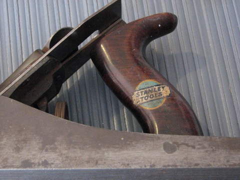

NO ONE scratches a LN! IF You have scratched your you will immediatly be sentenced to death by planing. A dull plane on your back for eternity... ;)
"NO ONE scratches a LN!"
Uh, oh. I better not mention that bronze beading tool....
Steve,
The LN Plane Police just flew past my house on a dead run. I'm between LN and you so trust me on this one!
"The LN Plane Police just flew past my house on a dead run."
It was touch-and-go for awhile....
The police (two of them, in plane clothes) arrived at my front door a short while ago. Having seen your message, I was prepared. As I opened the door, I lifted (with one hand, of course) my new Lee Valley #164-1/2 bevel-up smoother, holding it so that they were exposed to its shiny, mirror-like sole. The younger of the two officers immediately fell to his knees, clasping his hands over his eyes and screaming. The older one appeared to be wearing some kind of anti-LV contact lenses, however, and she just laughed. Out of the corner of my eye I saw her start to pull what looked like an adjustable-mouth block plane--with rodmaker's groove!--from her pocket. Thinking fast, I ran down to the basement and grabbed (with both hands) my newly-acquired Stanley #7C. I ran back up the stairs to find her at the top landing. I held the plane up so that she could see that the decal was still intact:
Upon seeing the decal, her shoulders slumped and she whimpered softly.
And then I bribed them with some fresh, homemade double chocolate brownies and they left.

I've ummmmmmmmmm...... 5 L-N block planes (nooo I don't have a fetish.... honest Guv)... said goodbye to regrets as soon as I'd bought the first one... no more would I need to blow head gaskets trying to use their predecessors... (names omitted to protect the shameless)...
