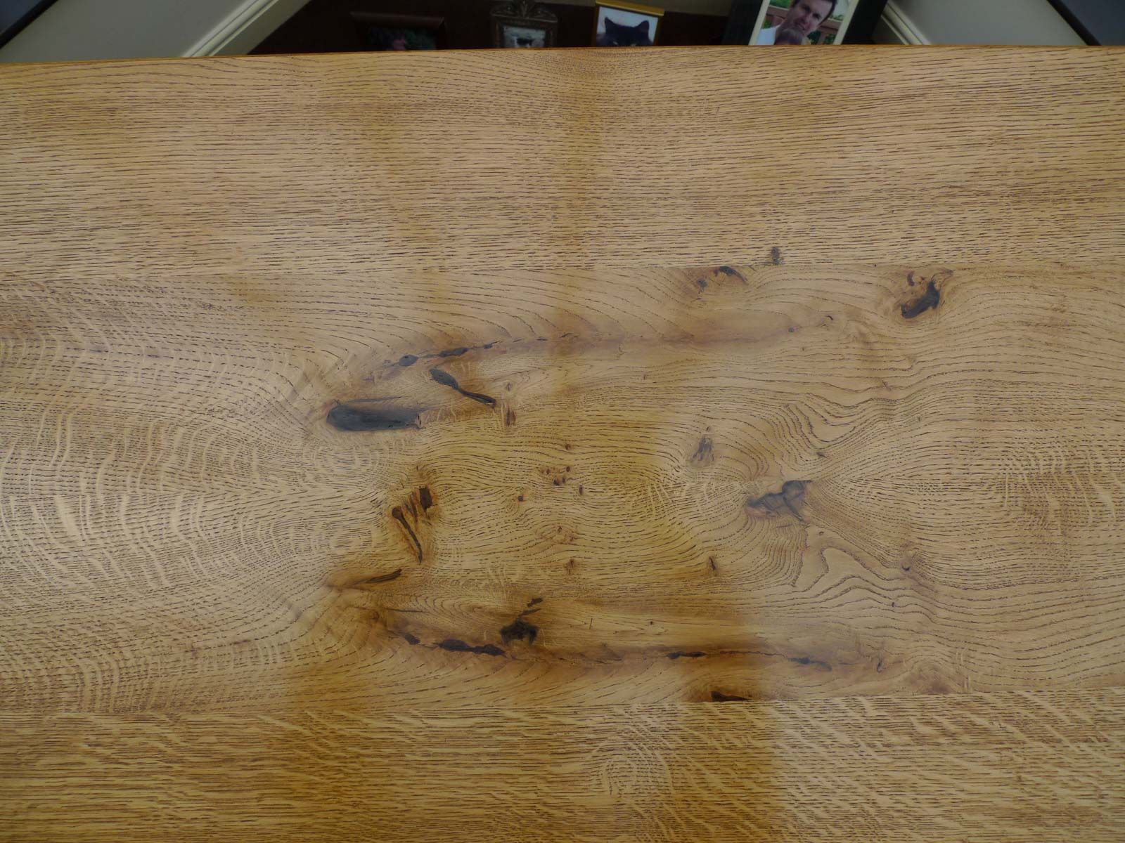

Here's the top of an oak table I made with interesting planks that needed to have their shakes and branch inclusions filled with beaumontage:
https://d4c5gb8slvq7w.cloudfront.net/eyJlZGl0cyI6eyJyZXNpemUiOnsid2lkdGgiOjE2MDB9fSwiYnVja2V0IjoiZmluZXdvb2R3b3JraW5nLnMzLnRhdW50b25jbG91ZC5jb20iLCJrZXkiOiJhcHBcL3VwbG9hZHNcLzIwMjFcLzAzXC8yODA3MDQyN1wvSGF5cmFrZS1jb2ZmZWUtdGFibGUtMi5qcGcifQ==
I us both shellac sticks and epoxy for this type repair.
The shellac sticks are expensive, about $8 each + shipping. Then you need the "hot thing", about $140 for electric or butane knife. Or an alcohol lamp and spatula about $20 + shipping and the fuel, $20 for a quart of Denatured alcohol. Then you have to wait on the hot thing to heat up or go back to the open flame to keep the spatula hot. Then remember to unplug the hot thing when you are done and wait for it to cool before putting it up.
A double syringe full of 5 min. epoxy is the same price as one shellac stick ($8). A small empty plastic yogurt cup (free), a small stick with a flat end (free), and sanding dust are also used. Mix and apply with the stick, adding the dust to color and thicken. Apply with the stick and toss what is left in the trash. No need for gloves or cleanup- as in no mess.
I will use the sticks on occasion depending on my mood but the epoxy generally makes more sense.
The sticks do have the advantage of using to repair and match an existing finish if you do that sort of thing.
Those Liberon beaumontage sticks will last one forever, assuming you're not filling great voids, in which case epoxy might be better - although it will look like a small pond of plastic in yer wood. :-) I have a ten pack of the sticks I bought 20 years ago, with plenty left.
For larger holes, a dutch patch over some home made wood-filler (glue + sawdust) is better, as you can often match the grain of the patch to the grain around the hole.
The beaumontage can be applied by holding the end of a stick in or next to the flame from a match, fag lighter or a-one o' them small kitchen blow torches. Personally I use a very small hand held heated spatula attached to a hand-held wee plastic box containing an AA battery, with an auto-off switch (hold it down continuously to heat the spat). This both melts the beaumontage and serves to spread the drips into the hole. I can't find one for sale just now but it was about ten quid a couple of decades ago.
Beaumontage can be mixed in the breach to get exactly the colour you want from two or more colours. It can also be easily melted and dug out to be replaced by a better dried-colour, if necessary, unlike epoxy.
Beaumontage is a lot faster, more accurate in colour and less wasteful than dollops of epoxy from a double tube, which consists of 10% glue and 90% plastic packaging waste. And if you store it for 5 - 20 years, the glue will go hard, as I know too well. :-)
