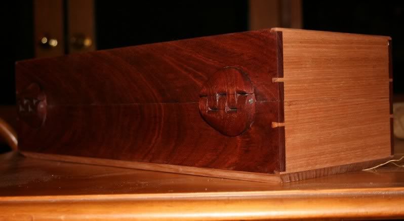

This is not my best dovetailing (I did it fast) …
She-oak, thicknessed first …
Marked ..
Sawn .. the trick is to gang them ..
Chiseling…
But this is the smallest dovetails I have cut (courtesy of Chris Vesper’s Small Dovetail Competition)!!
OK .. so what are the dimensions …?!
Imperial – well under 1/16″
… and Metric – under 1mm ..
It was fun!

I would not hesitate to say that would be impossible in she-oak in these pieces (which are a little under 1mm thick). This wood is extremely brittle. I was mad to use it but I grabbed the first scrap on half that got me close. This is extraordinarily hardwood, but also very brittle. I only managed 3/4 small centre dovetails. On half-broke. Imagine a half-lap .5mm thick ... (... giggle ....). :)
The little plane is a Mujingfang mini smoother in Ebony. Its smaller than your average block plane. 1/8 HCF blade on a 60 degree bed. Cheeep as chips. Fantastic smoother for small pieces.

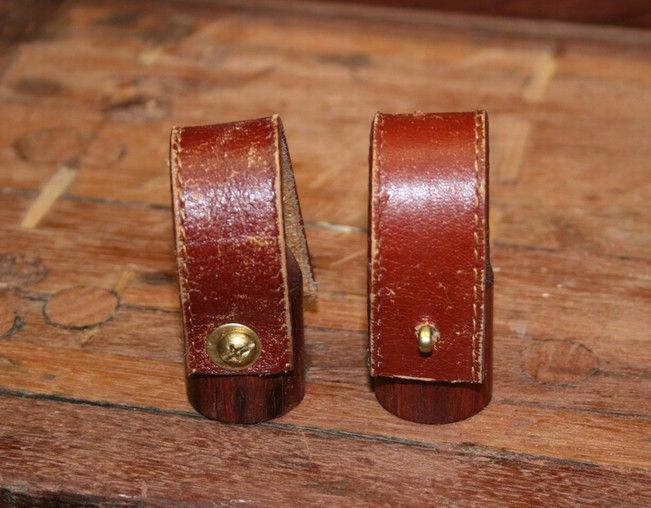

I could even live without the motor and forgive the plush box, but what the $^%$ is with all the %&% leather straps?
If I had to undo,redo all those straps every time I wanted to use it I would leave it on the bench .

The leather is not a fetish, although I understand that this might be your first thought.
Actually, this is a entry in an hand tool competition organised by the Australian Wood Review, the premier magazine in Oz. The leather is to make sure that the tools do not slide around when in transit. They are removeable (may be unscrewed from the rear) ...
