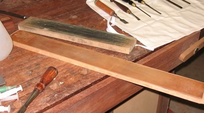

Hi Mel
I'm writing from work so I cannot give you dimensions. The TFWW strop is a decent length but still shorter than a barber's strop. I have one of the latter also glued to hardwood (much to Charlie's dismay), and these hang on a hook under my bench top. I haul them out as needed. Works for me.
The barber strop is as hard as the Horse Butt strop - it is probably also horse butt leather. It seemed to have a more obviously grain direction than the TFWW ones. Also I would say that it appears less susceptible to damage when you carelessly strop with out making sure that the blade is absolutely flat.
Having said those implied negatives about the TFWW strop, I must add that it is first class leather and that I bought the second one well after the first.
The reason I have mine glued to hardwood is that this minimises dubbing. The leather otherwise curls slightly. I know that many just hold the strop on a flat surface and use both sides. However I could see the blade dubbing. Note that this leather is very hard and has very little give. In my opinion it does have an advantage over hardwood (that is used as a strop) since the latter does not hold the rouge as well. I also prefer the feel from a (softer) leather strop.
Edited 11/21/2008 12:09 am ET by derekcohen
