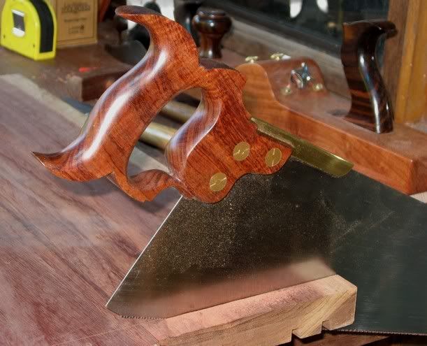

My birthday present in January from my wife was a Wenzloff half-back saw. This is so Sweet! It cuts straight, to the line, no worries.
Mmmmmm :)
