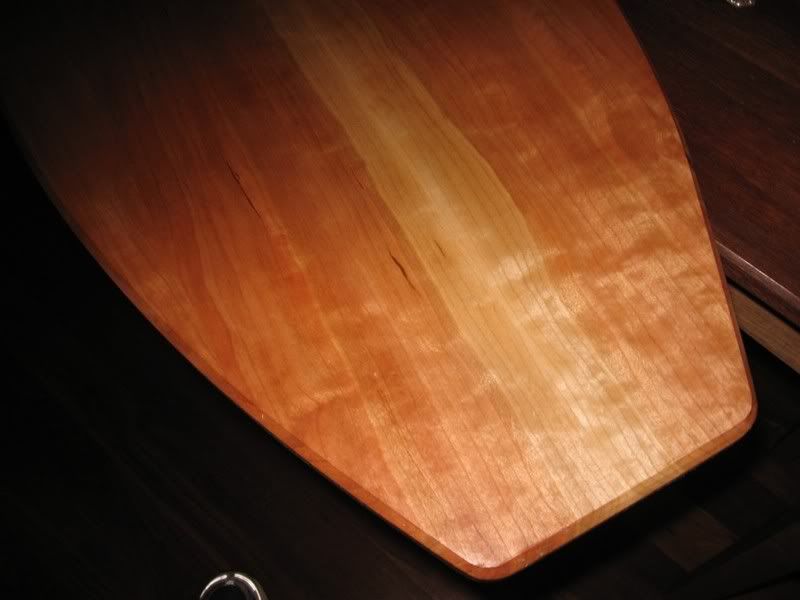

Of all the subjects that baffle and confuse me, finishing it towards the top of the list. I made a couple piggy-banks for my nieces out of some scrap cherry that has lots of figure and grain patterns in it. My intent was to finish it with Danish oil. I’ve tried some scrap pieces, and I like how the grain and color looks. That is my intention so far unless anyone thinks I should do something different. I was going to top coat it using a spray can of polyurethane. What I have is a water based, semi-gloss polyurethane. Is that okay over Danish oil or do I have to do an intermediate step between the Danish oil and polyurethane? Do I need an oil based spray instead? I would prefer the water based polyurethane if it’s okay with the Danish oil. Or, am I better off with a laquer instead of polyurethane. As always, any help would be appreciated. Thanks.
This is one of my favorite finishing techniques for many projects. I like to apply the Danish Oil (Watco) with fine sandpaper or a 3M pad. This makes a kid of slurry that will fill any pores in the wood and give it a nice, hand-rubbed look as well as bring out the grain patterns.
It is imperative to allow this coat to dry thoroughly before applying poly. I wait at least 3 days, and as much as a week if I'm not in a hurry. Then, I very lightly sand (you can use a 3M pad again) and apply the poly. I prefer the wipe-on poly to spray cans.
