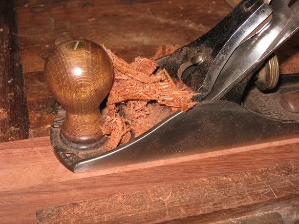

I am pretty certain that the blades were upside down by accident. However, something like this can be done deliberately. I have experimented with a blade that received a 45 degree grind. Used bevel up, this now created a 90 degree cutting angle ... in other words a scraper plane...
Here is in a Stanley #4 taking shavings in Jarrah. Not as good a finish as a high angle smoothing plane, but the concept works if you need a scraper plane to finish a broad expanse of gnarly grain.
