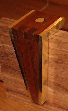

I have been using a Woodjoy dovetail marker for the past couple of years. It is a very well made and compact marker … but a little too compact and fiddly to be my ideal marker.
What I wanted was something less complex and more substantial. My first attempt was to make this one out of Jarrah. The ratio is 8:1
This is a great dovetail saddle … but it lacks bling! Surely that is the First Rule of Dovetail Markers – they must have bling. Soooo …
A nice piece of Tasmanian Blackwood and a length of brass…. and we have this… Ratio 7:1 (I always wanted a 7:1).
And for proportion, here are the three dovetail saddles together:
Thanks for looking.
Very nice dovetail markers. The one with the brass along the edges has circular inserts. Are those covers for screws, or are they metal dowels? I need to learn about joining metal to wood. Thank you.

The brass is held to the wood with a combination of epoxy and steel rod (dowels). They provide a very tight friction fit.

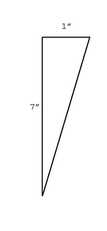

As usual, your workmanship is remarkable. I am going to ask a question out of ignorance. What is meant by the dovetail ratios, 8:1, 7:1, etc. Why not just deal in degrees, 14 degrees, 12 degrees, etc? Thanks. Tom
Thanks for the kind words Tom. If you only knew how long this one took to make!
1:7 (or 7:1) is the ratio of length to width when calculating the dovetail angle.
Why do it this way? Probably because it is easier to calculate. Just use a sliding gauge to mark it out.

The pin on the pivot for the saddle square goes all the way across. The side pins only go in deep enough to fix the brass to the side of the Jarrah.
The accuracy of this square depends on the accuracy of the square saw cuts you make and the tightness of the interlocking joint. It makes for some good saw practice! The end result can have no lateral movement. The vertical movement is also affected by the accuracy with which you drill the pin - a little off centre and the two pieces will swing out of square. As I mentioned in the other thread, this is tougher than it appears in the picture. Drill from each side. I set this up very carefully by clamping the pieces to a fence on my drill press.

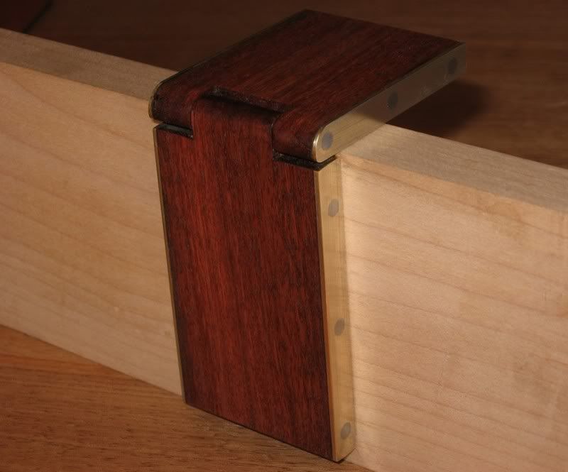

Here is the saddle square again:
Unlike the saddle square, the dovetail saddle needs to be fixed. A flexible saddle square is useful for off centre corners, but it is unlikely that one would cut dovetails on anything but perfectly square sides. So the dovetail saddle is a fixed design.
To build the dovetail square I first dovetailed the wood and shaped the dovetail angle. I then cut the brass to fit and drilled it for the steel pins. Note that the top of the vertical pieces are bevelled at the angled junction with the horizontal brass strips (so the fit flush with each other). The brass is then epoxied to the wood. Once dry, the wood is drilled for the pins using the holes in the brass as a guide. To attempt to drill the brass and wood together will creat so much heat that it will melt the epoxy (DAMHIK). Grind all flush (I used a belt sander and files), check the angles are accurate, refile as needed, smooth down with a deburring wheel and polish up with rouge on a cloth wheel. Done. Easy-peasy :)
