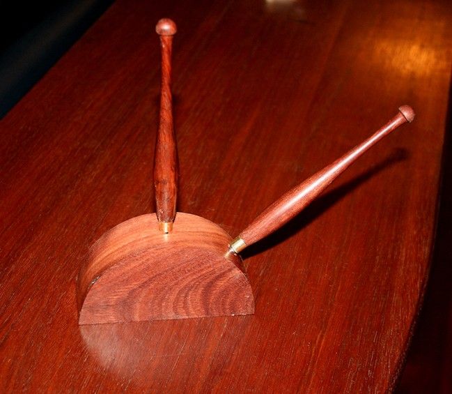

Further to Mel's post, very durable detail knives may be made from HSS jigsaw blades. I've made literally hundreds of these over the years (a few on this forum can let you know how the blades hold up).
There is a construction tutorial on my website. I recently updated this with a jig to grind these small blades: http://www.inthewoodshop.com/ShopMadeTools/A%20Knife%20for%20Marking%20Dovetails.html
This Jarrah detail knife and scratch awl set was a gift to a good friend ..
