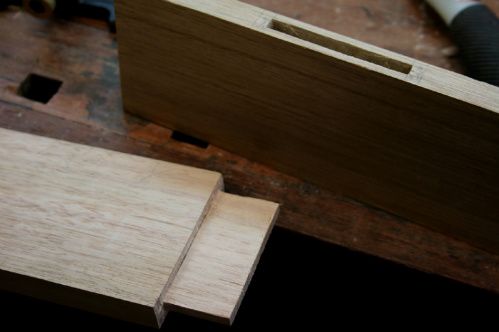

I have just placed a new article on my website: A Primer for Handcut Mortice-and-Tenon Joints. Part 1: The Blind Joint. (link inbedded).
The wardrobe is taking shape, and I thought I’d take a few snaps of these joints along the way (as I did recently with the sliding dovetails).
As always I am open to ideas for changes, or just to hear about your methods. Anyway, the handtool forum has been quiet for a while, and this may spark some discussion.

Very nice stuff. Lately I've stopped marking out a double line for the mortise as I only reference one line anyhow...not a big savings of time.
The real question is how much tension in the fitting of the tenon to the mortise. For cabinet doors and the like, I believe tension free and yet solid is the rule. For that reason I use router bits and tenon jigs and leave the hand done stuff for tables and the like.

I note this: "I laid out the 3 ¼” wide boards to create a tenon cheek 2 ¾” wide - that is, the length of the rail less a ¼” shoulder at each end. "
I think it should read " ...the width of the rail less a ..."
You might also consider explaining 'the rule of 1/3s'.

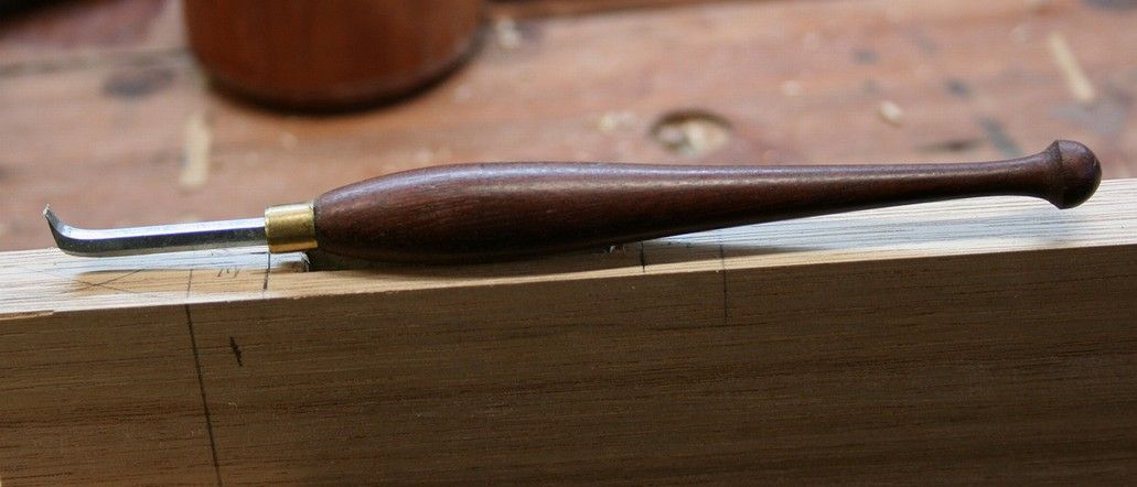

Another fine post. Thanks! Tell us just a bit more on construction of the L-shaped clean-out chisel from an allen wrench. From your other various posts, I would guess that the basic shaping was done with a dremel tool. Did you do any heat treatment to bring the metal to proper hardness? Or are allen wrenches a decent hardness to begin with? Or doesn't it matter since you are not really cutting much, more just levering out chips?
thanks,
Randy
Hi Randy
The "bottom cleaning chisel" is really more of a scraper-and-picker than a chisel.
I used a good quality allen wrench - the steel on the cheapies is too soft - and then just ground it to shape. No heat treating necessary. I think I shaped it on a belt sander. The handle was just something I had lying around - one of my spare marking knife handles.
