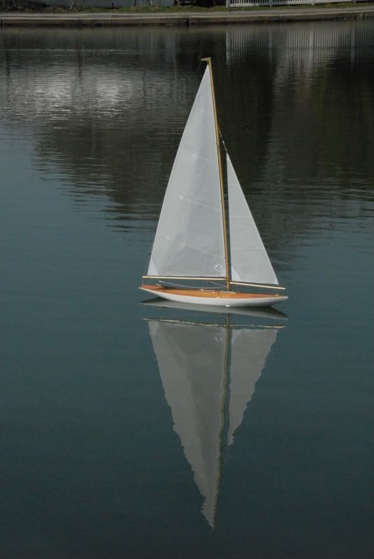

This is what I was doing today, speaking of model boats.
A friend just redid 'Barbara' for me, and today was her first sail in many a year. Her exact age, and original name, if any, are unknown, but Andy is pretty certain she was built about 1930. Her namesake, Barbara, was one hell of a sailor and was the Maine Champ as a kid, but I don't recollect the class. She was also quite the equestrian, ranked #2 in Maine.
A very classy lady, I'm pleased to have had her influence in my younger years.
I think youve just posted a pic ture of the boat my customer has in mind..........for $25-$30. Ill have to re-educate her into the realities of life visa vis the cost of materials and working for more than 35c /dy if this is the case.
That is a beautiful boat.......... "the most beautiful thing ever created by man is a sailing boat".......... someone said it; dont know who
